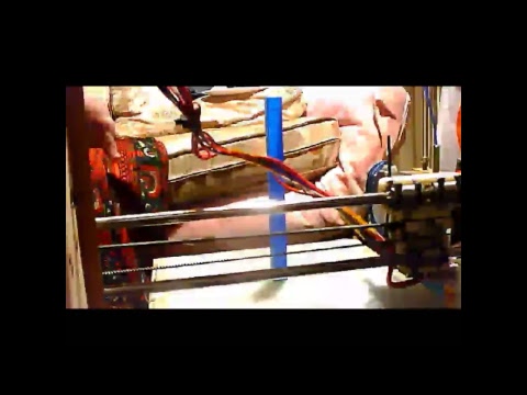

  • I made 2 video's doing some measurements on the problem.
    x,y, axis measurements
    Part one
    part two
    Michelle

    OK so after running the Pen drawing test it has shown some opposite alignment issues which means I have moved something that half corrected the problem but moved it to the other side, I am uploading the video now and will be LIVE while fitting new brackets.
    Video of the pen draw test is here might still be uploading:

    I will be going live in a few minutes to try out the commandline square writing with a pen on 3DP
