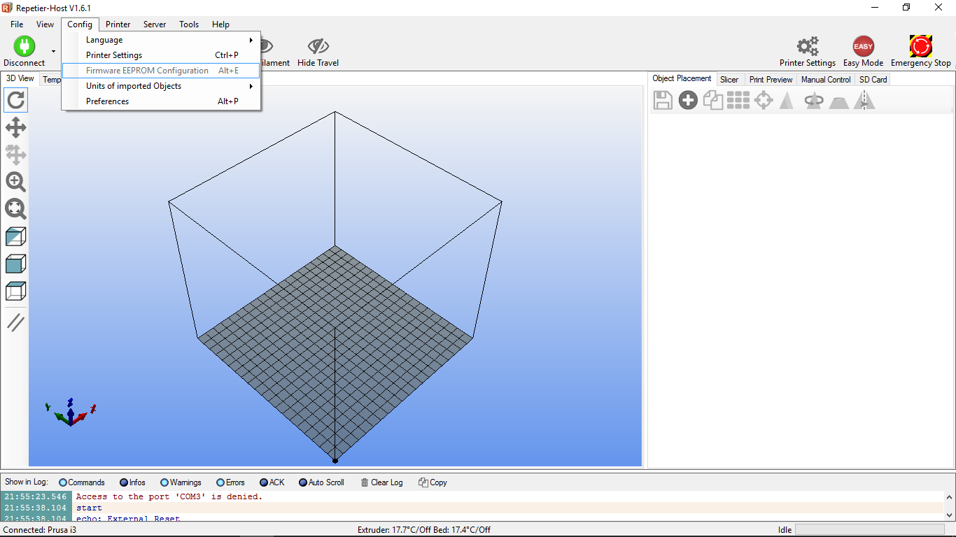

  • OK I went to go to the eeprom settings but I can not click on the option. My printer is connected and powered on. Any idea on why I can't select it?
    The only thing I can think that could be causing the issue would be the fact that I have to stop the local server to connect to my printer. Not sure if it has anything to do with it but its the only other issue I have.
    here's a screenshot:
  • It only enables if it detects marlin or repetier using the M115 string. Your firmware then seems to have a unknown identifier. If it is repetier you can still switch to repetier-server which has a firmware selector in config and does not rely on M115 any more. For marlin use the according M commands.
