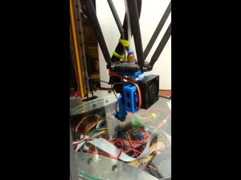

more info:
in action:
you can see it get all twichy as the effector moves down, but then it pauses and no more twitch.
  • Interesting result. Sounds like crosstalk of heater cable modifies the signals to servo.
