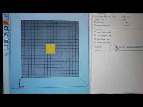

  • Sorry, you're right, I refer the gcode preview indeed
    My english is not so good, so I made a short video:
    I choosed a light model 38ko, a cube 20X20X10
  • Ok, that is definitely not correct, also it does not happen for me on several computers. So big question is, what makes this happen. Can you enable log and see if you see any error messages there? Also which os are you using? Does not look tile W7/8 more like xp or vista i guess.
